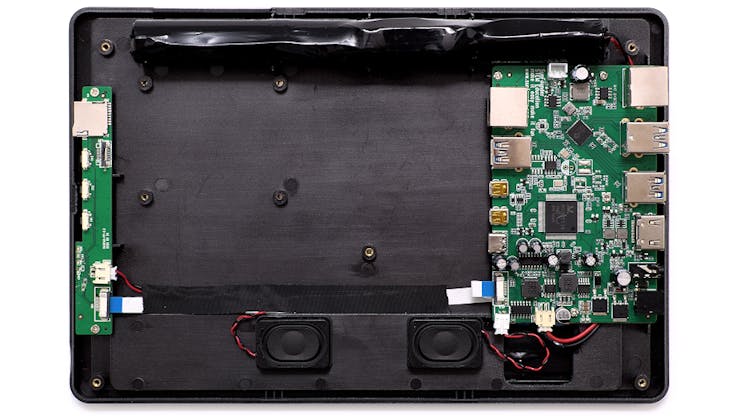

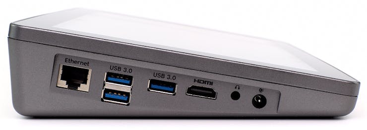

Everything else, though, appears at either edge of the tablet body via two daughterboards: The primary board handles charging the internal three-cell 3Ah lithium-polymer battery, offers analog audio output via 3.5mm jack, wired Ethernet, three USB 3.0 ports — which share a single USB 3.0 lane back to the Raspberry Pi inside — and, new for the upgraded model, a full-size HDMI output for a secondary display. A smaller breakout board on the other side offers LEDs for battery monitoring, buttons to control power, brightness, and volume, and an externally-accessible microSD slot.
![Installation is relatively easy, but watch out for those cables when fitting the centre screw. (📷: Gareth Halfacree)](https://hackster.imgix.net/uploads/attachments/1189885/image_UKaeBvqfA1.png?auto=compress%2Cformat&w=740&h=555&fit=max)
Internally, the Raspberry Pi mounts behind the 10.1in 1280x800 IPS capacitive ten-point touch display and connects to the secondary board via a clever microSD-shaped PCB and ribbon cable and the primary board via a USB 3.0 cable, Ethernet cable, USB Type-C cable, and two micro-HDMI cables — one for the on-board display and one for the external HDMI output. There are two small speakers which fire downwards through the rear shell of the case and provide a surprisingly loud output — albeit treble-heavy.

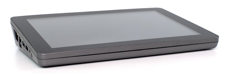

Overall the tablet measures about 270x127mm with an odd wedge shape which goes from 22mm at the front to 47mm at its widest. It's a shape which makes it easy to stand up on a desk as an upright display and which holds it at a gentle angle for flat use — but which means it's awkward to use handheld like a traditional tablet.

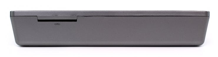

Sadly, there are a few design flaws to note. Access to the Raspberry Pi's general-purpose input/output (GPIO) header, for one, is provided by passing a 40-pin ribbon cable through a cut-out in the rear of the case. If you assembled it without a cable — which isn't provided in the bundle - you'll be taking it apart again to fit it, and if you then want to take the RasPad 3 somewhere without the cable you'll be undoing and redoing the five retaining screws for a third time.

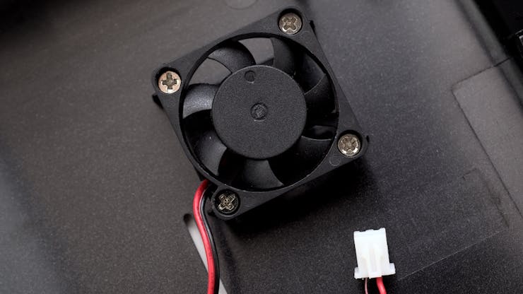

There's a bigger flaw, too: The cooling fan is, for some reason, held proud of the rear of the case by four plastic stand-off pillars. While this may help to prevent noise — though, sadly, the fan is still clearly and annoyingly audible — it brings the blades into contact with the bundled heatsink on the SoC, preventing them from turning. The only way to get the fan to work is to remove the case's screws yet again and crack the case slightly - or, for a more permanent fix which doesn't ruin the RasPad's potential as a portable computing device, file the plastic pillars down.
UPDATE2020-09-14: SunFounder has notified us that the fan issue is more quickly resolved than that: The fan should be installed the other way up as an intake rather than an outtake, in which configuration the pillars insert partway into the fan and reduce its height enough for the heatsink to clear the blades. Changing the configuration on the test unit confirmed this, though had no measurable impact on the heat generated during the below-graphed stress test benchmark.
![The fan offers impressive though loud cooling, but is easily installed incorrectly - as pictured. (📷: Gareth Halfacree)](https://hackster.imgix.net/uploads/attachments/1189892/image_5306OlH8Yg.png?auto=compress%2Cformat&w=740&h=555&fit=max)

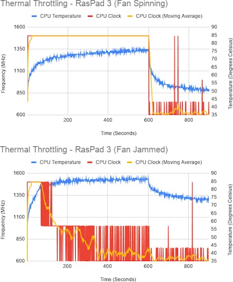

The fan isn't exactly optional, either: During a thermal torture test, with the case cracked to allow the fan to run, the RasPad 3 was able to keep the Raspberry Pi 4 below the 80°C soft-throttle point — but when the fan was jammed, the SoC reached 80°C and began throttling after just one minute - and by two and a half minutes into the test had begun throttling as low as 600MHz from the chip's stock 1.5GHz.
![The noisy fan keeps the Raspberry Pi cool, but if it's disabled throttling is rapid and severe. (📷: Gareth Halfacree)](https://hackster.imgix.net/uploads/attachments/1189881/image_l6txJuFam7.png?auto=compress%2Cformat&w=740&h=555&fit=max)

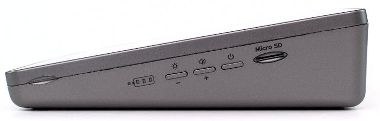

![Hardware buttons control brightness and contrast, but the OSD doesn't rotate with the display. (📷: Gareth Halfacree)](https://hackster.imgix.net/uploads/attachments/1189893/image_N6eu6f6Pja.png?auto=compress%2Cformat&w=740&h=555&fit=max)
The final issues are more niggles than true flaws: A bundled accelerometer shim, installed on the Raspberry Pi 4's GPIO header, allows the tablet to automatically orient the display as you rotate it — but it only affects the Raspberry Pi's video output, not the on-screen display for adjusting the brightness and volume. There's no link between the battery management circuitry and the Raspberry Pi, either: When the battery is running low, you'll see an on-screen overlay but it won't trigger a safe shutdown; nor will telling the Raspberry Pi 4 to shut itself down actually turn the tablet off until you press and hold the power button on the side — and if you forget, you can expect the battery to have drained completely by morning.

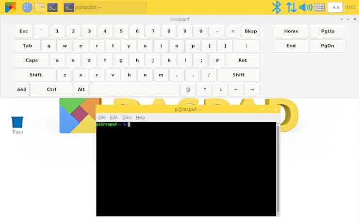

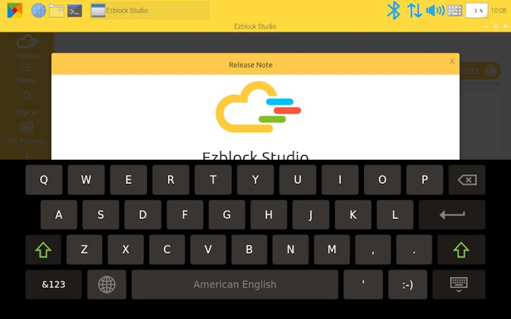

Another tweak is the inclusion of an on-screen keyboard, or rather two: Running selected programs pulls up a dark-theme large-interface on-screen keyboard, but other programs — including the Terminal — don't bring the keyboard up. These rely on a different keyboard, accessed through an icon in the system tray, which has a smaller interface and a light theme. In both cases, though, they take up at least half of the usable display — and with a resolution of 1280 x 800, it doesn't leave a lot of room for your programs.
![The Android-inspired default on-screen keyboard takes up a large chunk of the screen. (📷: Gareth Halfacree)](https://hackster.imgix.net/uploads/attachments/1189895/image_dfaAJbHwkf.png?auto=compress%2Cformat&w=740&h=555&fit=max)

The custom OS has other issues, too. A FAQ icon should provide quick access to on-device help, as a supplement to the assembly-focused printed manual; in testing, though, it simply brought up a blank screen. The touchscreen works as expected, except it doesn't hide the mouse cursor — leaving it on-screen at whatever point was last tapped. The build is based on the 32-bit release of Raspberry Pi OS, leaving performance on the table — particularly for anyone who has splashed out on the 8GB model.
![The second on-screen keyboard is triggered manually for selected applications, like Terminal. (📷: Gareth Halfacree)](https://hackster.imgix.net/uploads/attachments/1189896/image_O1UFDy9XO8.png?auto=compress%2Cformat&w=740&h=555&fit=max)
